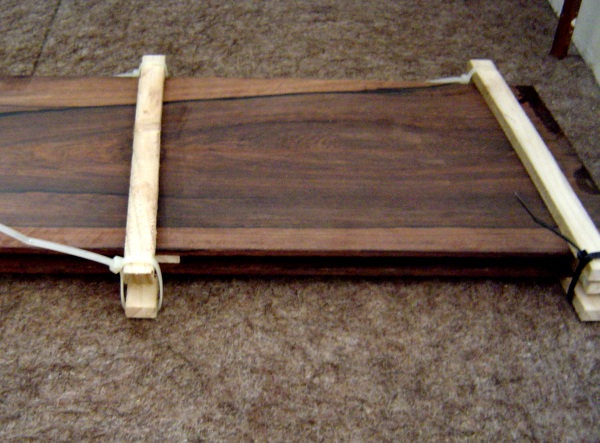

Lance wet the cocave sides and place the convex sides together with stickers between. Put stickers to either side and add cable ties to the ends of the stickers gradually tighten the cable ties to flatten the wood, never failed. (famous last words!)
ColinColin S38948.4262962963
